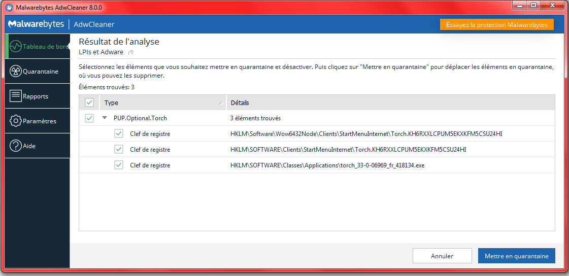

voici le dernier scan
Re: Virus ? HELPPPPPPPPPPPPPPPPPP
https://up2sha.re/file?f=ewIAb7
https://up2sha.re/file?f=hTizPpQPbznMFI28yP
les 2 derniers scan adwcleaner
